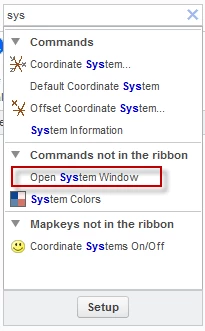

Use the built in purge command. No you don't get to choose how many versions to keep. You just get the latest of each file.
Pick the magnifying glass in the upper right of Creo
Type in sys, then pick Open System Window. (for some reason they have hidden the command in Creo. It used to be in the pull down menus)
[cid:image001.png@01CF6B61.283A41A0]
That opens up a command prompt in the directory that is your current working directory. This command window also has any environment variables that were set when Creo was launched.
I naturally assume since you're working standalone that you have set your work directory to where your files are.
Type "purge" in the command window and then exit the window. You can type "exit" since your hands are already on the keyboard. Done!
It's worked this way since the beginning.

I stand corrected. That system window doesn't know about the parametric/bin folder.
When I look at the path in that command window it only contains these Creo paths:
C:\ptc\Creo 2.0\Common Files\M090\x86e_win64\lib;C:\Perl64\site\bin;
C:\ptc\Creo 2.0\Common Files\M090\x86e_win64\deflib;
C:\ptc\Creo 2.0\Common Files\M090\libs\dfor\lib
So by default your system doesn't know about the commands down in the parametric load point:
C:\ptc\Creo 2.0\Parametric\bin

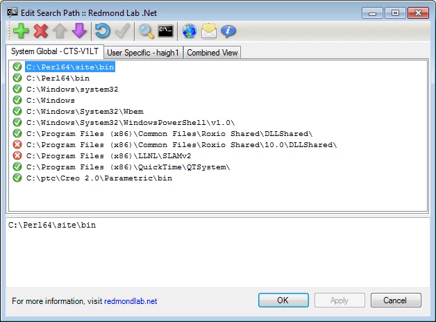

The easiest way to add this is to download a program called Redmond path. Here:

Ok, assuming you can't use Redmond path to extend your path, you can do it in a bat file. Call it mypurge.bat
set set PATH=%PATH%;"C:\ptc\Creo 2.0\Parametric\bin\
purge
Open up the system window like I describe and type mypurge.
Your path may be different than mine.
You will want to put your bat file some place that is in your current path.
Type set and a return to see what's in your path.
But like I said Redmond path is simpler.
[cid:image001.png@01CF6DB7.6E7248E0]
However, I do believe you can use Redmond path to do what you want, Notice that in the screen shot above there is a User Specific tab.
You can use that to add to your path. You should be able to extend your path with the path to the parametric/bin folder.
