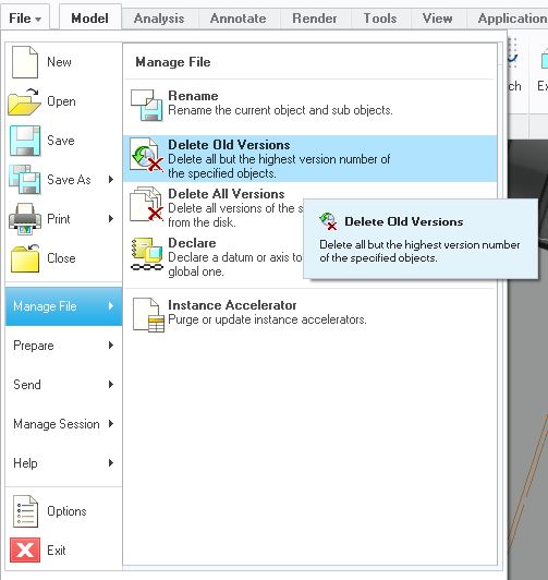

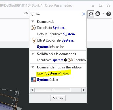

Spekan is the tool of choice, but there is a built in basic purge utility in Creo.
If you do a command search Creo (upper right corner of the screen) and type in "system" you'll find near the bottom "Open System Window:
That will open a command prompt window in your working directory where you can type in "purge".  That will clear out all the old versions of all your Creo files.  Of course, you can also open the command prompt directly and browse to any folder and do the same.
There's also the "delete old versions" command in the file menu.  This will only remove the old versions of the file you have open, so you'll have to do it one at a time for each file in your directory.
As far as this being an antiquated system, perhaps it is.  it's also immensely useful. Having a record of saved versions means that I can save often during concept exploration and not worry about saving over and loosing my earlier concepts. It means when collaborating with another person and one of us accidently saves the assy, overwriting the other's file,  I can "go back in time" and recover the lost work.  The config option mentioned above will turn this off in Creo 3, but I'd urge you to work with it and a good purge utility and you might find that you like it.
