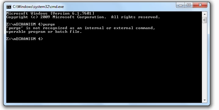

Hi all
i would like to know how to purge working directry so that the size doesnot grow unneccesarily.While i have selected working directry and when i give purge command in cmd it gives error.the image of the error is attached.kindly help.

Jun 22, 2013 11:54 PM UTC
You need to add the Creo BIN path to your system path (environment variables)
(...c:\etc...)\Creo 2.0\Parametric\bin

DavidKhan1-VisitorAuthor
Jun 25, 2013 4:52 PM UTC
but the black windows flashes and then disapperas.is there any another problem?
Jun 26, 2013 5:29 AM UTC
you can create custom mapkey for purge.
Here is the video for you: http://www.youtube.com/watch?v=RHLXsWtPojc
... and/or, here is the purge makpey "pu" *(copy to your config.pro file):
mapkey pu @MAPKEY_NAMEPurge command;@MAPKEY_LABELPurge;@SYSTEMpurge;
