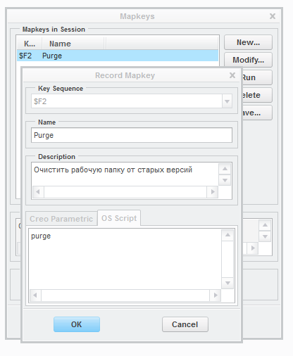

    November 28, 2012
    Create mapkey

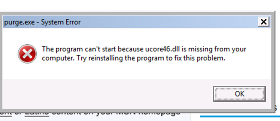

    Ok, the purge command has worked. I purged about 20 folders 2 of them returned this error and would not purge. Any thoughts?
    November 29, 2012
    Interesting... yes, I've seen that error too. There are actually 2 files that it has trouble finding. Oddly enough, PTC has several versions of that file floating around for different products.
    I found the Creo version of the file and put it in the windows system32 location where all DLL's reside.
    You might also put in a customer service ticket to find out how to avoid this error. I haven't seen it since I copied the appropriate files to the System32 folder, but it would be good to know what is actually suppose to happen.
    Maybe that is what taking ownership of the Creo application folders is suppose to solve. I haven't done that on the latest install (M020)
