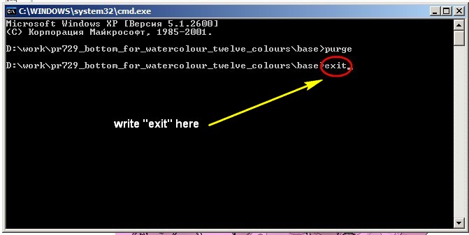

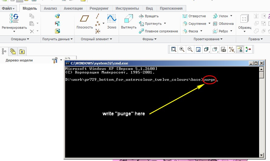

Hi
Try to use Purge.bat available in bin folder
See the linked discussion for details
http://communities.ptc.com/message/167395
If you still face problem , please reply

Michael,
open Command Prompt window and enter PATH command. You will see the content of PATH variable. To be able to run purge.bat, you have to ensure, that PATH variable contains the path to bin subdirectory in Creo installation (on my PC it is G:\usr_wpx\Creo1_M040\Parametric\bin and G:\usr_wpx\Creo2_M010\Creo 2.0\Parametric\bin).

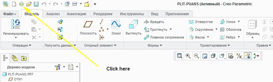

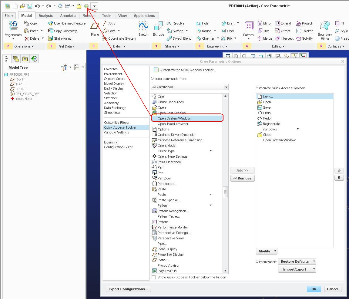

Hi
Thank you Vladimir
I had missed one thing;
That is:-
Open System window is not available by default in quick access toolbar or in ribbon;But is available in all commands
We can add this to quick access tollbar. And can use this as we used in Pro-e Windfire.
