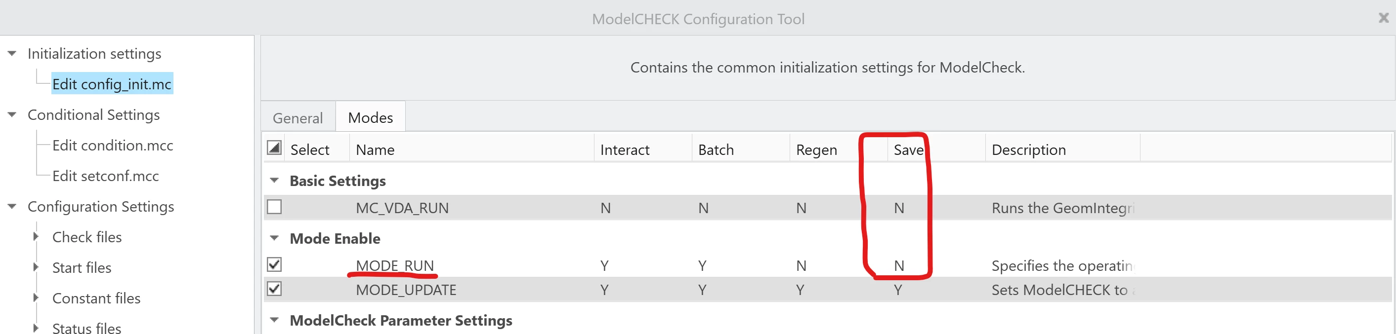

To stop ModelCHECK from running on save, you need to disable this in config.init file.
Set N for MODE_RUN with Save mode. When you set Y for Interact mode then you can manually run MC whenever you need it.

Jun 4, 2026 3:22 AM UTC
