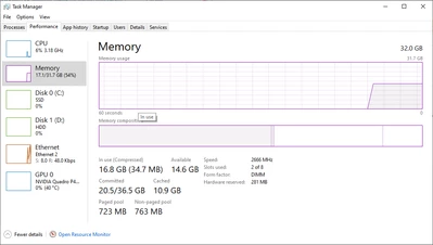

I have 32 gig of ram and on occasion have ram issues but I would say that it is generally some sort of glitch in the program and/or computer and is usually resolved by a restart (Creo or re-boot).

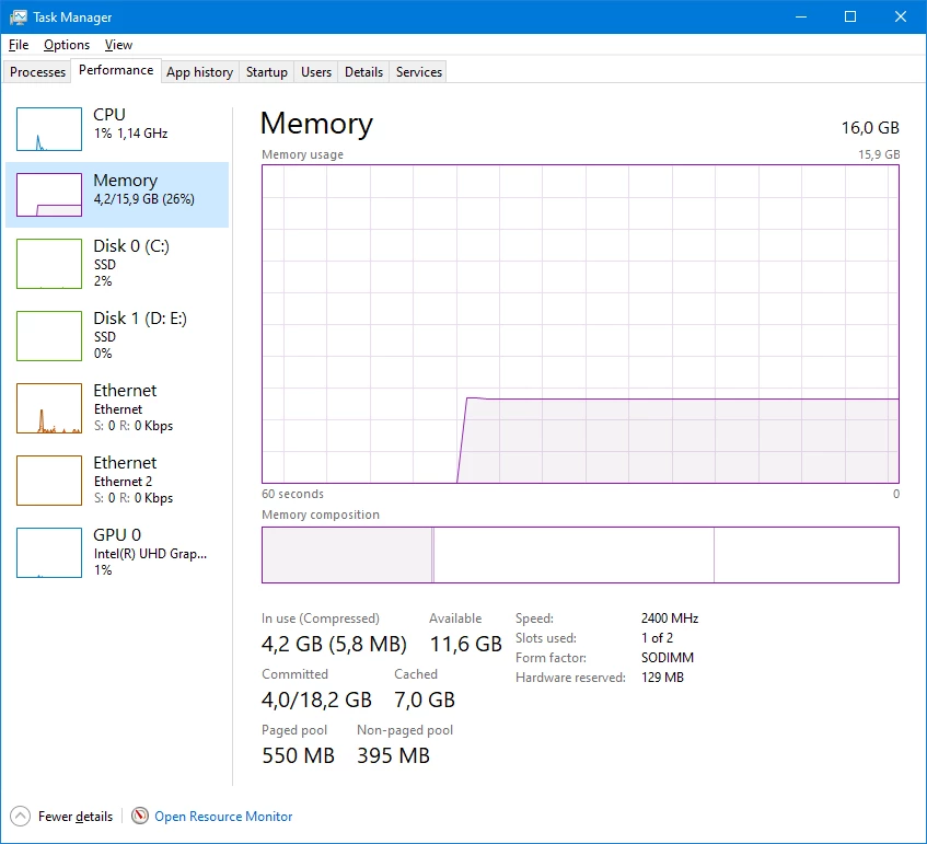

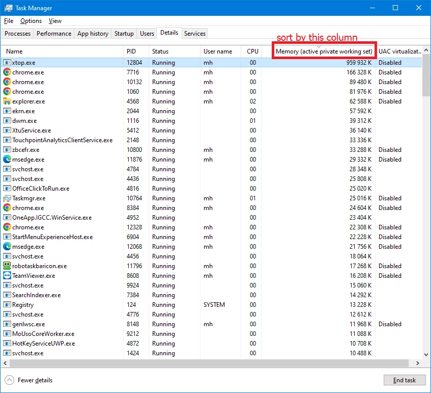

July 12, 2023
open assembly and track how much memory takes xtop.exe process (in Task Manager window on Details tab).

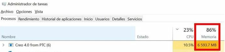

Having only one open box model, it is with almost 90% of the RAM consumed and the PC freezes continuously for sometimes seconds, sometimes even several minutes, making it very difficult to work.
Currently I have 16 GB of RAM
July 12, 2023
exit Creo session, start new Creo session, open assembly and publish following "pictures".

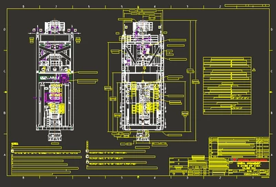

The problem is that this happens to me when I open AD (assembly drawings), which are assembly drawings of the whole box, then I can not simplify, and every time I open the model is 20 minutes and since you move the mouse until it moves 15 seconds pass ....
