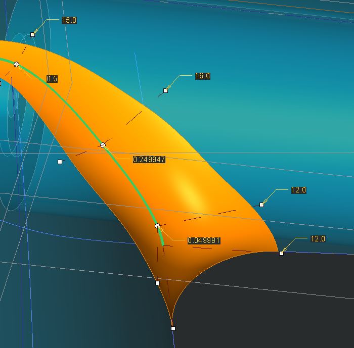

Our client's default units are mm and their config file has default_dec_places set to 1.
With normal dimensions, within the feature creation the value rounds to a single decimal place, but if you edit the feature (not edit definition) you can type in a 2 or more decimal number and Creo retains the value, but displays it as one decimal place.
I'm having issues, however, with ratio dims, in particular the dims that place the radius points in a variable round:
I can drag those points and Creo gives me the 6 digit, somewhat random numbers above.  Creo seems to snap in roughly 0.05 increments, however if I enter 0.05 Creo converts it to 0.1, 0.25 becomes 0.3, etc.  I cannot enter in dims in smaller increments than 0.1 and I cannot drag in increments smaller than roughly 0.05.
In this case I need the fine control to put those points where I want. Is there a way to set Creo to ignore the default_dec_places setting for ratio dims?
Best answer by dgschaefer
Found it.  I had this in my personal config:
default_dim_num_digits_changes no
I don't remember why I set it but removing it (the default is yes) fixed the problem.

You will probably need to manually edit the number of decimal places for each of the dimensions when outside of the feature, then go back into edit definition and redefine.  (Similar to sketcher behavior.)
August 16, 2016
I agree, but with a variable radius round, the point positions aren't available when you edit the feature, only the radius values.
August 16, 2016

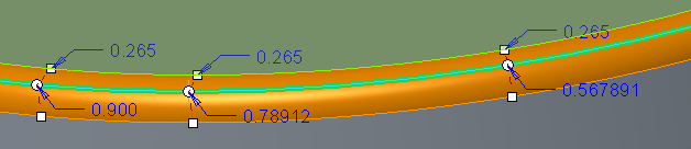

Hmmm.  Good point.  Just tried it myself.  With default decimal places set to '3' the number is never less than three digits but will expand up to six digits as the number requires.
I'm not seeing the automatic conversion from 6 digits back to 3 (for anything other than zeros)...
