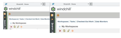

As per this thread - same problem
Yes, I can confirm that this issue is present again in 8.0.1.0
Oddly, the scaling seams only to appear, when a browser window is pop-out (e.g. you click a link, that opens a new window with Windchill).
But this instantly scales also the content of the docked window.
(before and after)
I tried the solution/workaround described by llie, but unfortunately this did not solve the problem.
(before and after)
I can confirm the same issue with 8.0.1.0. I have also just downloaded 8.0.2.0 and the issue seems to be fixed.
PTC has updated the embedded browser version:
  • Creo Parametric 8.0.0.0 and 8.0.1.0
    • chromium version 85.0.4183.121
  • Creo Parametric 8.0.2.0
    • chromium version 91.0.4472.124
Which you can get by doing a chrome://version in the url bar of the embedded browser or see the ptc article CS187581

Also have this reoccurring in Creo 9.0.4 only on one bit of hardware.
Setting the OS scaling to 100% instead of 125% resolves it, but the browser_os_scale key introduced for Creo 7 has been removed in later version, despite it fixing the problem.

I don't remember the exact name of the option, but it's documented in CS358790.
Unfortunately when I queried if the option was available beyond Creo 7, PTC made the article customer-invisible- as they have retired it in later versions after deeming the issue resolved.
Certainly exists and worked in Creo 7.0.10, but no longer recognized by Creo 9.
Certainly the config itself was undocumented and not available in the config search/finder, but would indeed still work.
