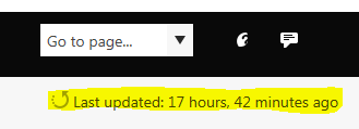

First, it normally only sends data once per day. This is controlled by prefs.xml located in <install location>\DiagnosticTools\text\xml
You can force it to send immediately by deleting the contents of the "unprocessedFiles" and "SentFiles" folders.
Second, from what I can tell PTC's website also only updates once per day. You can see this on the top of the details pages.
