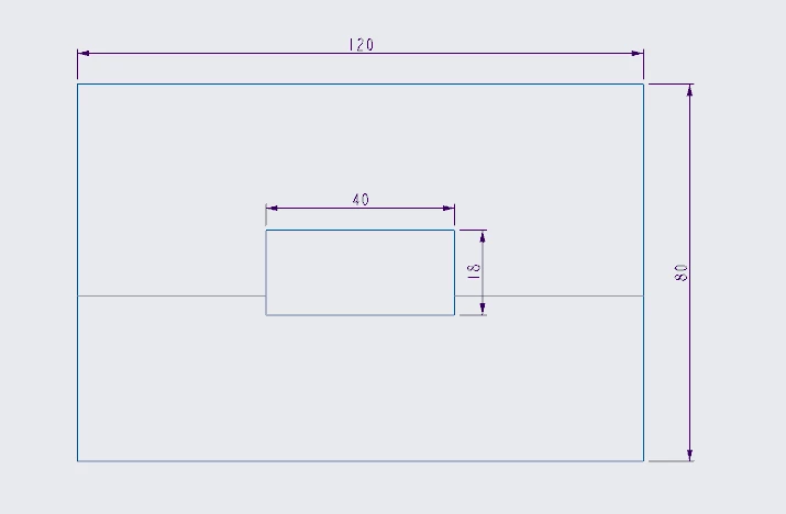

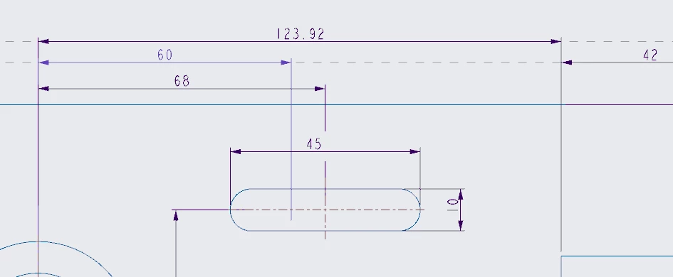

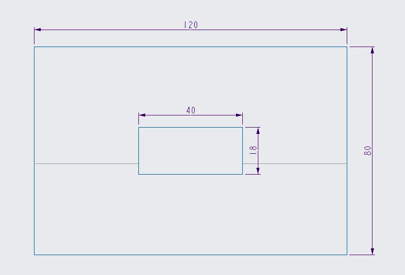

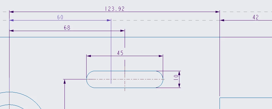

Here in our company we have been setting the enable_opengl_fbo=no since a long time ago when we notice an increment of the crash while using Creo 2, now we are in Creo 4.0 M060 with planning to move to M100 soon.
Some users have been complaining about the appearance gallery colors and its icons being too dark not able to be recognized properly and after reviewing some post in the community we found that if we turn on the enable_opengl_fbo=yes the issue is gone and now the colors are being displayed correctly.
However we have some reports of users having issues with drawing edge display as showed in the images attached.
Have you guys experience something like this while having this setting activated? do you have any recommendation for this setting? I would like to hear about your experience managing this settings.
