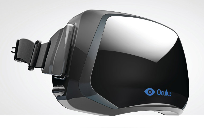

    I have played with something like the Oculus rift but the technology is not there yet.  but soon....?oculus-rift-concept.jpg
