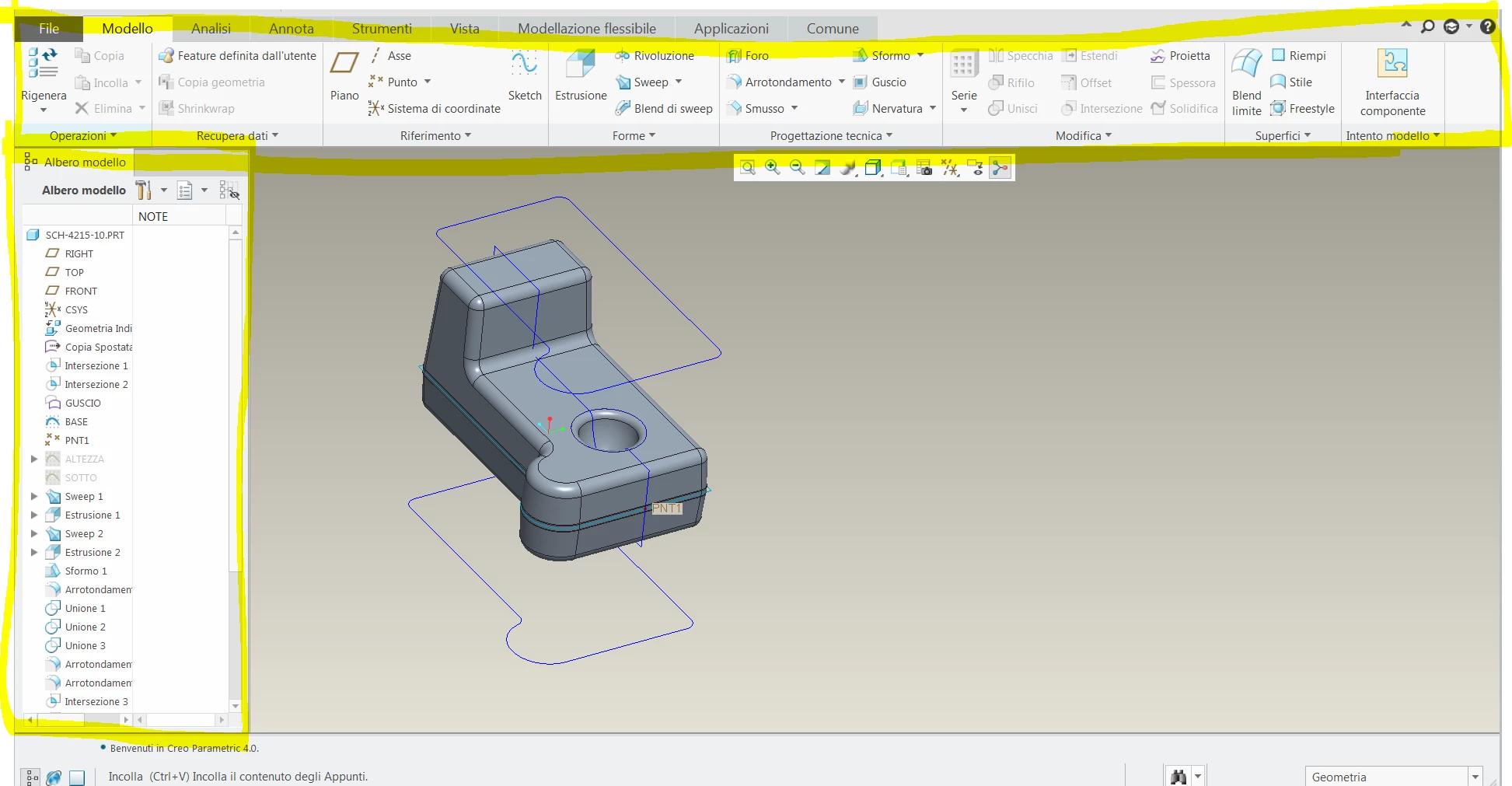

Anyone knows how to reduce this bars? In my laptop 17" they are quite big. I don't like full screen mode.
Thank you.

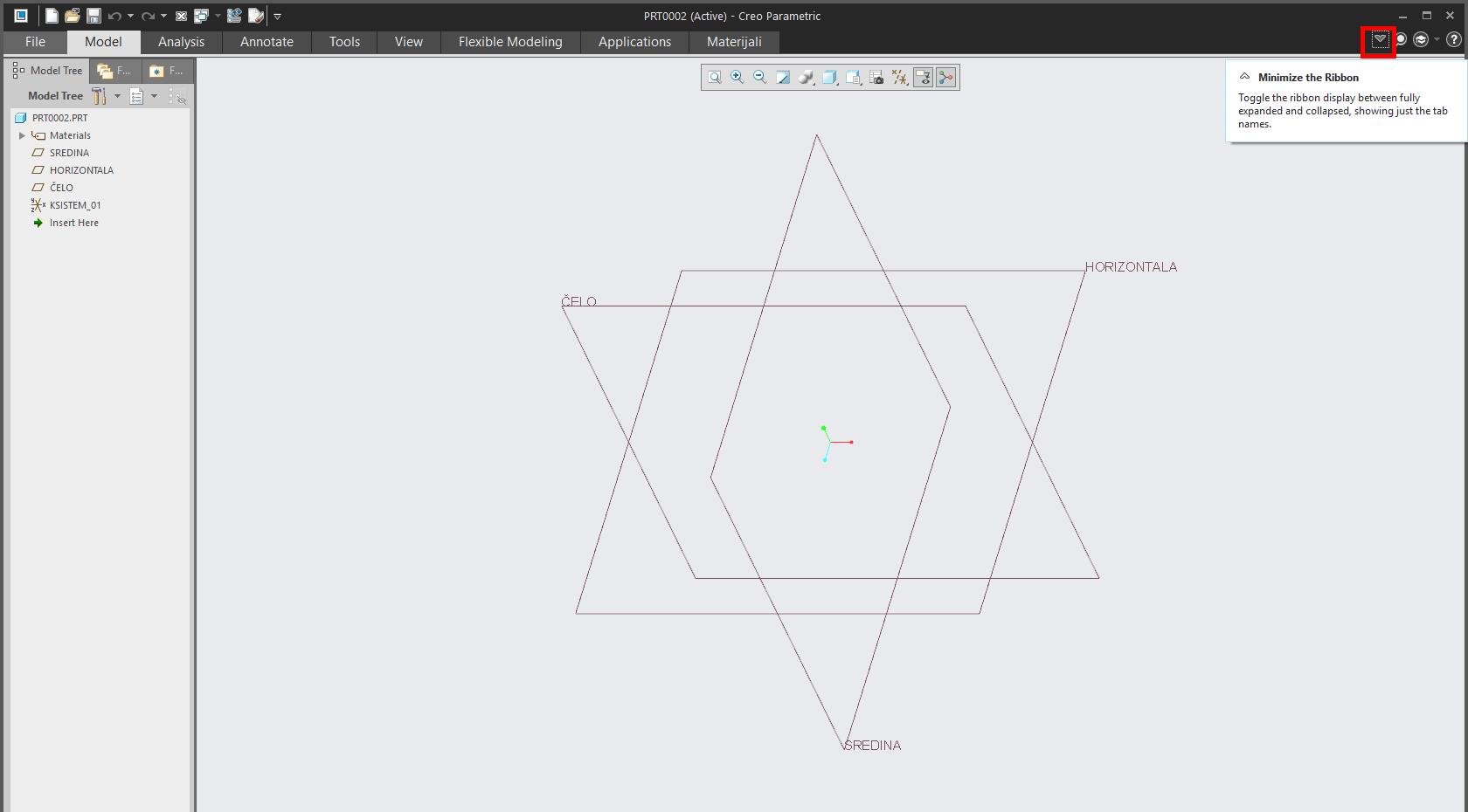

    How about minimise toolbars?

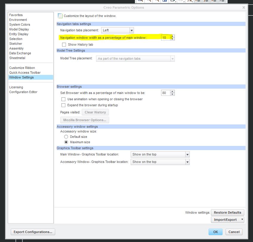

    There's no way that I am aware of to change the height of the ribbon.  The model tree can be changed through the "Windows Settings" are of the Options dialog (at least in Creo 2 & 3):

    You can also move your Windows toolbar to the side of the screen instead of the default bottom of the screen.  That frees up some vertical screen room.  The only other option is minimizing the ribbon.

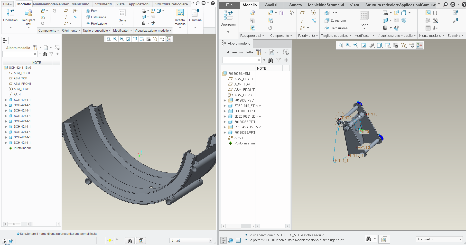

    I think model_tree_font, default_ui_font, Windows Settings helped me a little. On the left Creo3, Creo4 on the right.
