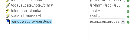

End of many tries, i guess i found the solution.
a kind of browser option in config.pro
windows_browser_type <--that is.
we changed that option value ie_in_sep_process (Frakly speaking, we set the value 'mozilla_based_browser' and we it seems to work right, but Creo parametric client are shutted down soon. it's weird....)
it seems to solve the problem, but we can't sure that option effects and even the reason why this option is effective.
is there any reasons or relations between graphical error and browser type which embedded in creo parametric?
i found one thread.
http://www.proesite.com/cgi-bin/find_option.cgi?srch=WINDOWS_BROWSER_TYPE&ver=creo1
architecture and workspace, large assemblyand child process blablablah....
separating browser process can effect the graphic..?
