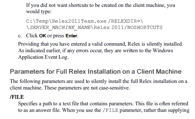

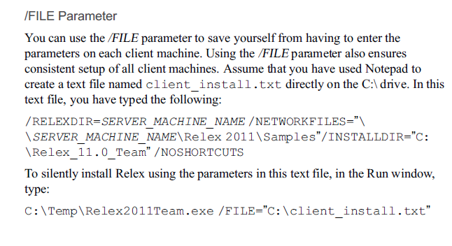

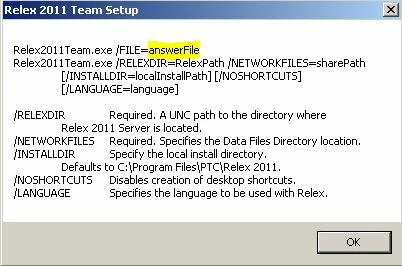

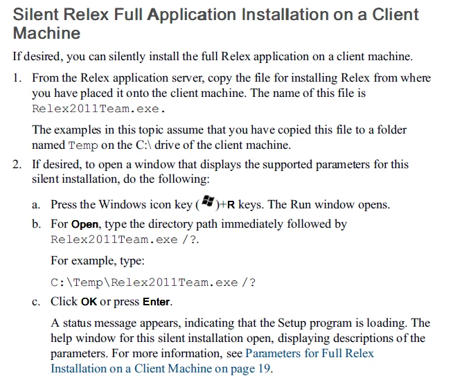

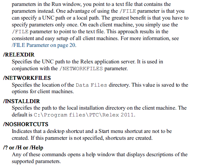

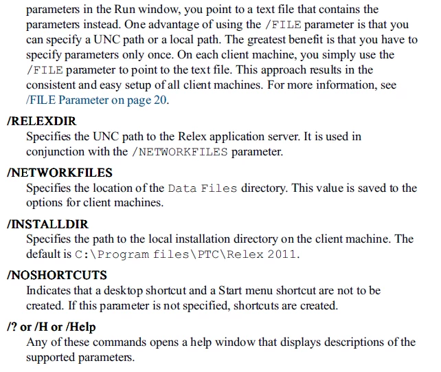

Could you please tell me how to install Relex 2011 Team silently.
After getting install switches I can see limited information. So far I can see that only solution how to install this software silently for my case is with answerFile, but there is no guide how to create one.
Could you please tell me how create answeFile or please give me some location where I can see install docomentations?

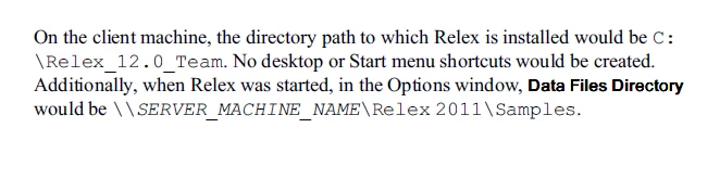

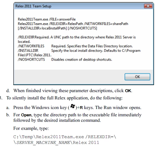

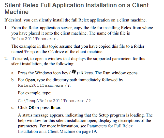

Hi Toms,
Below shows the screenshots from the manual "Relex 2011 Team Installation Guide". You can find two manuals "Relex 2011 Team Installation Guide" and "Relex 2011 Getting Started Guide" in attachment. We have new "Windchill Quality Solutions - General" community. Next time you can post your questions there: http://communities.ptc.com/groups/relex-genera?view=discussions
