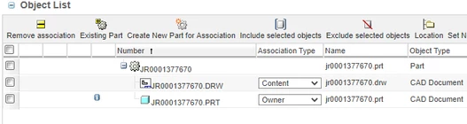

Oct 6, 2020 3:02 PM UTC
The answer kind of depends on your environment and whether or not you're using WTparts but...
  1. Locate the drawing in the workspace
  2. Right-click on the drawing
  3. Select Edit Associations

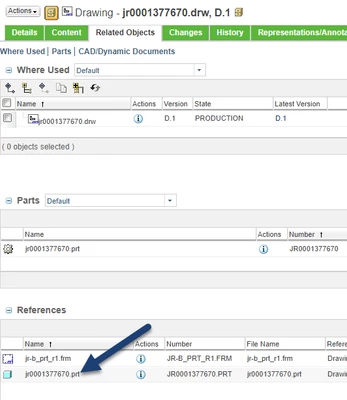

If the drawing has been associated to the model, it will look something like this:
If you need to remove an association, you can select the object and click the Remove Association button. If you're using parts, this action will check the WTpart out in commonspace. You'll have to check it back in to finish the association change.
Here's some light reading:
http://support.ptc.com/help/windchill/wnc/r11.1_m020/whc_en/index.html#page/Windchill_Help_Center/MCPR_EditMenuCADDocPartAssociate.html
You can also view associations on the Related Objects tab.
