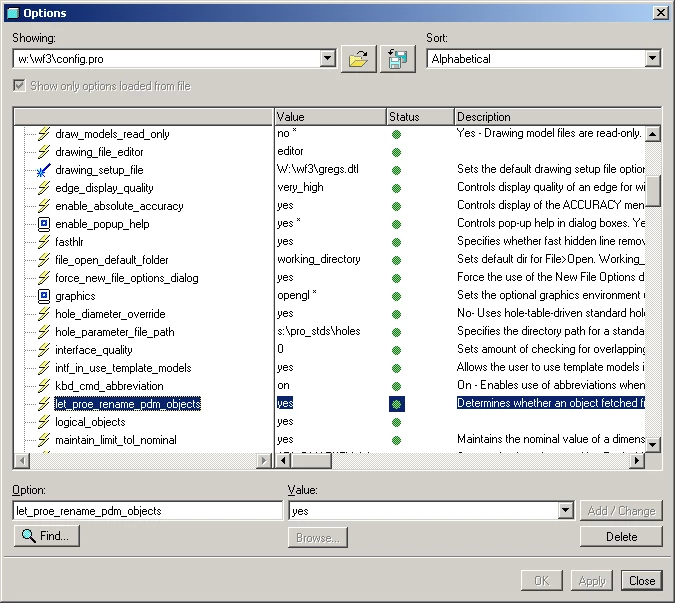

Set the config option 'let_proe_rename_pdm_objects' to yes.

FYI, if the object is already in commonspace and you use this config option, you will simply create a new object.
If it's not in commonspace, then no worries.
