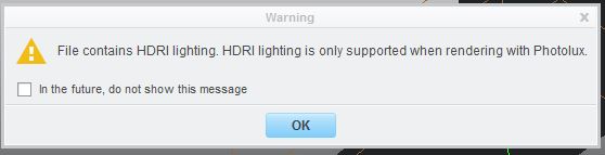

Whenever I switch to creo 2.0's rendering tool the following message pops out.
I am unable to get the rendering effects, as most of the light and special effects are off.
I am unable to understand how to activate or install the Phtotlux.
Anyone who has already faced the same problem or having the solution to this problem kindly help.

Hi Nachiket,
please check whether you license contains the module Advanced Rendering Extension 2 (code 283). This module is not included in basic Creo license.

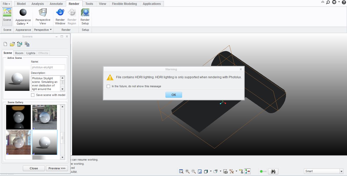

Jan 9, 2015 5:57 PM UTC
Usually when you don't have the "Photolux" license, you should not be able to create HDRI lighting.
But it may happen, if you use a scene that has been created with Photolux, that you get this warning, because your scene saved with the model contains functions the simple "Photorender" render cannot use.
If you have not purchased the Photolux render, you probably have to use different scene or rework the scenes.

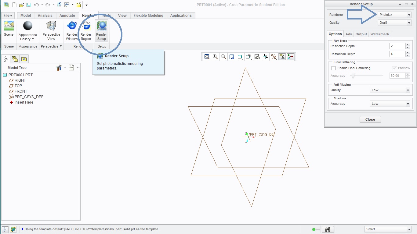

Mar 18, 2015 2:05 AM UTC
Is this helpful?
The photolux rendering option is included in Creo Parametric 2.0 Student Version, which is free.
