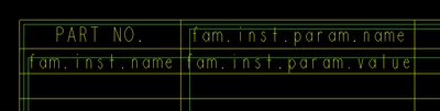

This is my 2d repeat region.  For the 3 columns after "J", I would like to report them as "BACKPLATE", "ENDRING", & "BLADE".  But I would like to leave the rest as-is.

This is a 2-d repeat region so they come directly from the family table.
And here is how the 2-d repeat region is on the drawing:
Since it's a 2-d repeat region, it fills out the columns and rows automatically from the family table.

Hi @TimothySchrand ,
Two-directional repeat regions cannot have header and this is per limitation in Creo. So, it is not possible to have separate column heading.
I hope this will answer.
