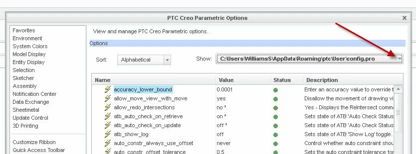

It is ok to have multiple config.pro file. You just need to make sure you are saving your changes to on that loads.
You can check what config.pro files loads by selecting the drop down arrow.
Below the image is from another post by Tom Ummin with explanation of the config pro and how and where it loads from.
Here is the official word from PTC technical support (CS28227😞

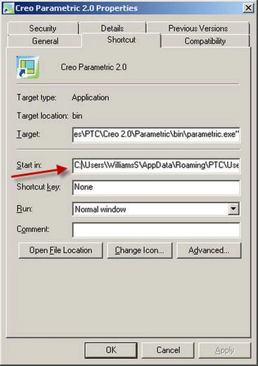

1. When you start Creo, what config.pro files are loading and where are they loading from? You can use the image I added in the previous post to determine that.
2. Do you have write access to the config.pro that you are attempting to modify? Maybe you are adding the option and when you save it, it can't save due to windows permissions issues.
3. Do any of the config.pro files have have search_path option you added? Switch to each config.pro file listed in the drop down and look for the search_path option. If it is not listed, the option isn't loading.
4. If it is listed, is the path correct? Maybe you typo-ed the path.
5. The startup directory is the directory listed in the properties of your icon you use to start creo, is that the same directory you put your config.pro into? See image below for finding the startup directory by right clicking on the creo icon and then selecting properties.
