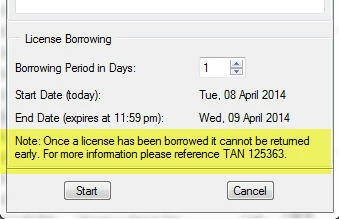

Hello all,
Anyone know if it is possible to return a borrowed proe/creo license?
I've seen the message in the proe_borrow.bat UI (attached) which says that you cannot. Is this really the case? Seems ridiculous, it's not hard to imagine this being seriously detrimental.
Have tried using ptcflush.bat, it gives the message (paraphrasing) 'cannot return a linger license'.
Using creo\elements 5.0 M150
Thanks!

user can do early return of borrowed license also in case that he uses FLEXnet 10.8.
Two commands can be launched from DOS prompt window.
1.] eg. D:\PTC\Creo2_M100\Creo 2.0\Common Files\M100\x86e_win64\obj\lmutil lmborrow -status
The output of this command informs user what license is borrowed.
2.] eq. D:\PTC\Creo2_M100\Creo 2.0\Common Files\M100\x86e_win64\obj\lmutil lmborrow -return LICENSE_NAME
LICENSE_NAME is displayed in the output of 1-st command.
This commands returns back borrowed license.

it is good that you are using M150 - because in previous releases licenses cannot be returned.
To achieve it install license server version 11.10.1 (FlexNet) or FlexNet lmgrd version 11.10.1
In FLEXNet:
1) stop license server
2) make changese in <FLEXNet_load_point>\conf\server.xml file:
<licenseServer adminOnly="true" .................... licenseReclaimAllowed="false"
-- To --
<licenseServer adminOnly="false" ................... licenseReclaimAllowed="true"
3) start the license server
User machine:
1) add environment variable "ENV=PRO_ALLOW_EARLY_RETURN=true" int the *.psf file prior to checking out the license from the server
Return the borrow license early
1) Open command prompt with administrator privileges
2) Change the default path of command prompt to “<load_point_of_Creo Elements>\Pro5.0\x86e_win64\obj”
3) Use the following syntax to return license:
lmutil lmborrow -return -c <port@servername> <license feature name>
good luck
