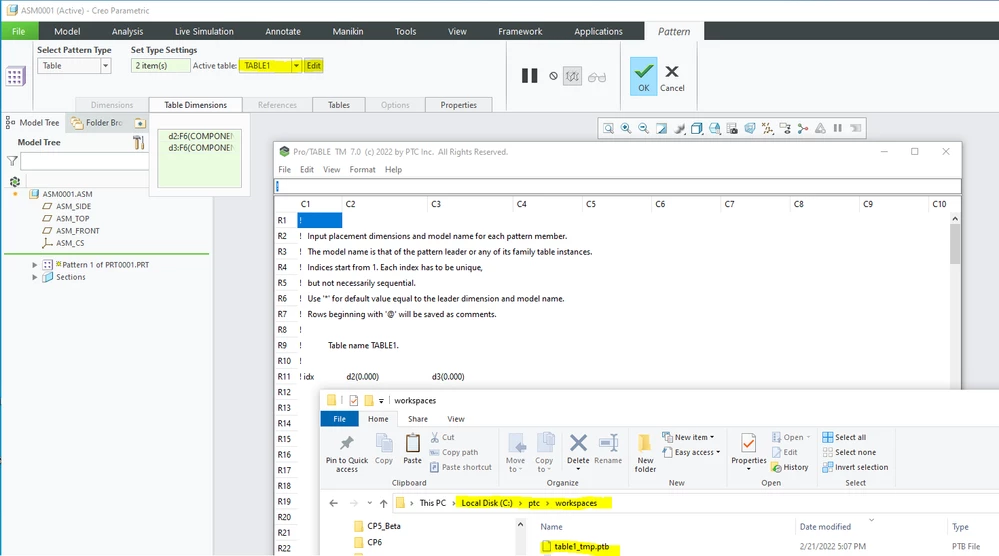

For our group, Creo is running off the network share, and they don't have write access to that location (as admin, I do).  When trying to open Pro/TABLE to edit a pattern table, they are unable to do so.  I imagine Creo needs to create some sort of temp file in order to do this, but can't due to write permissions.
Setting the option PART_TABLE_EDITOR to Excel doesn't work, as the same problem exists. (Ref https://www.ptc.com/en/support/article/cs32249)
Have you run into this, and if so, how did you solve it?
I'm considering copying protab.bat over locally, then telling Creo where that is with the option PRO_EDITOR_COMMAND, but haven't tested it yet.

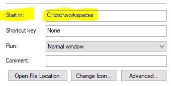

Feb 21, 2022 10:13 PM UTC
Users must have write permissions to Creo's start-in (working) directory.  This location should not be on the network.  It can be set right in the startup shortcut.
I have no trouble accessing the table editor with Creo running from the network because the temp table is created in my local working directory:
Feb 22, 2022 3:14 AM UTC
Perfect @TomU !  That resolved the Pro/TABLE issue.  I'll continue to investigate running local vs network.
