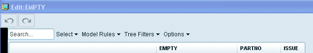

I have a need to add columns to the simp rep component chooser using "options - column - more"
Does anyone know if there is a way to save the coumn display in the simp rep component chooser?
The "options - save tree" does not seem to work the way I expected it (I expected it to work similar to the "save settings file" in the model tree which creates a tree.cfg file that loads every time Pro/E is started)
It is annoying to have to add the column display to the component chooser everytime one opens Pro/E.
Example of component chooser with three added columns:

Jorgen, columns in Simp Rep component chooser are sticky inside session. If you need an ability to have them sticky between sessions, you can file a case with customer support and it will be considered for implementation.
