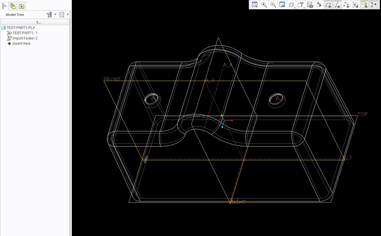

Jun 24, 2014 12:40 AM UTC
I use ap214_is and it askes if you want to export Annotations. Which imported back in looks like this.
