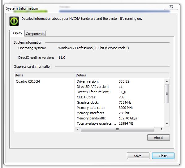

    May 16, 2016 12:44 PM UTC
    After a year and a half of flashing screens, including several graphics drivers and builds of Creo, I installed the latest video driver from Dell (353.82) this morning and the screen flashing is now gone.
