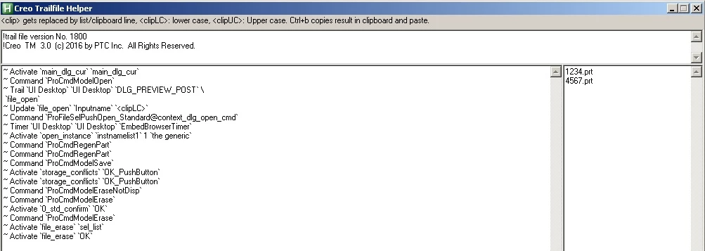

I used autohotkey for this task in the past, because of the clipboard functionality. But i'm sure it is easy to convert to work with files. In the top is the header, in the left text field the trail content and in the right text field you can put the list of files. File list can also be in clipboard. But you need autohotkey (opensource tool) to run or compile it to an executable.
