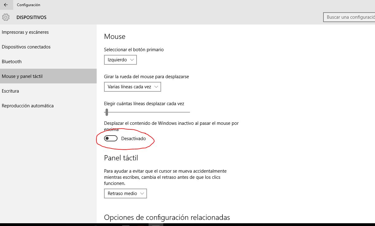

hi. i cant use the scroll of my mous3 in ptc creo 2.0. i cant make zoom with it. the scroll of the touchpad of the toaptop doesnt work in creo too. the scroll of the microsoft mouse works correctly but in creo i cant make zoom with the scroll. what can i do??

If that does not solve your problem, the issue may be with how your touchpad drivers handle Mouse3 and the scroll. Different vendors customize the drivers in various ways. Lenovo, for example, has mouse3 set to activate panning mode (forces window scrolling left/right and up/down without activating the command for scrolling the mouse wheel). You may want to check your drivers to see how they are treating scrolling. The location of the settings should be under one of the tabs in "Mouse Properties" on the Control Panel.

Before it was working. Now it doesnt work with Windows 10.i think is it

Hi, I also have windows 10 and just solved this problem.... (you will have to apologize me, because my system is in spanish) you need to go to your computer's device settings, try to find the "mouse" option, and deactivate where it says something about similar to... displace the inactive content of windows when passing by with the mouse on top of it. (check the image... as I said, in spanish)
Hope it works for you!

This worked for me thanks
April 10, 2016
Thank you Laura that worked correct !!!
