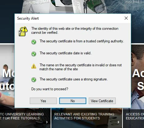

Security Alert Message on Creo 4.0
Whenever I start Creo 4.0, this error message pops up. I reinstalled Creo several times, and it doesn't go away. I have the student version.
2-Explorer
Feb 15, 2018 8:40 AM UTC

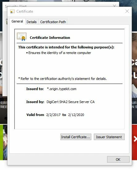

This looks like a message produced by the internal browser about a default website. It isn't a problem with Creo, so reinstalling won't work to fix it.
What message pops up when you select "View Certificate"?
blubot41-VisitorAuthor
Feb 16, 2018 11:50 PM UTC
Sorry for the late reply.
Here it is.

As @dschenken mentioned this is related to browser. Found a post from Microsoft Community, this may help. Better involve IT to correct this
https://answers.microsoft.com/en-us/ie/forum/ie11-windows_7/security-alert-the-identity-of-this-web-site-or/73ed5064-7977-480e-951d-426039ef8265?auth=1
