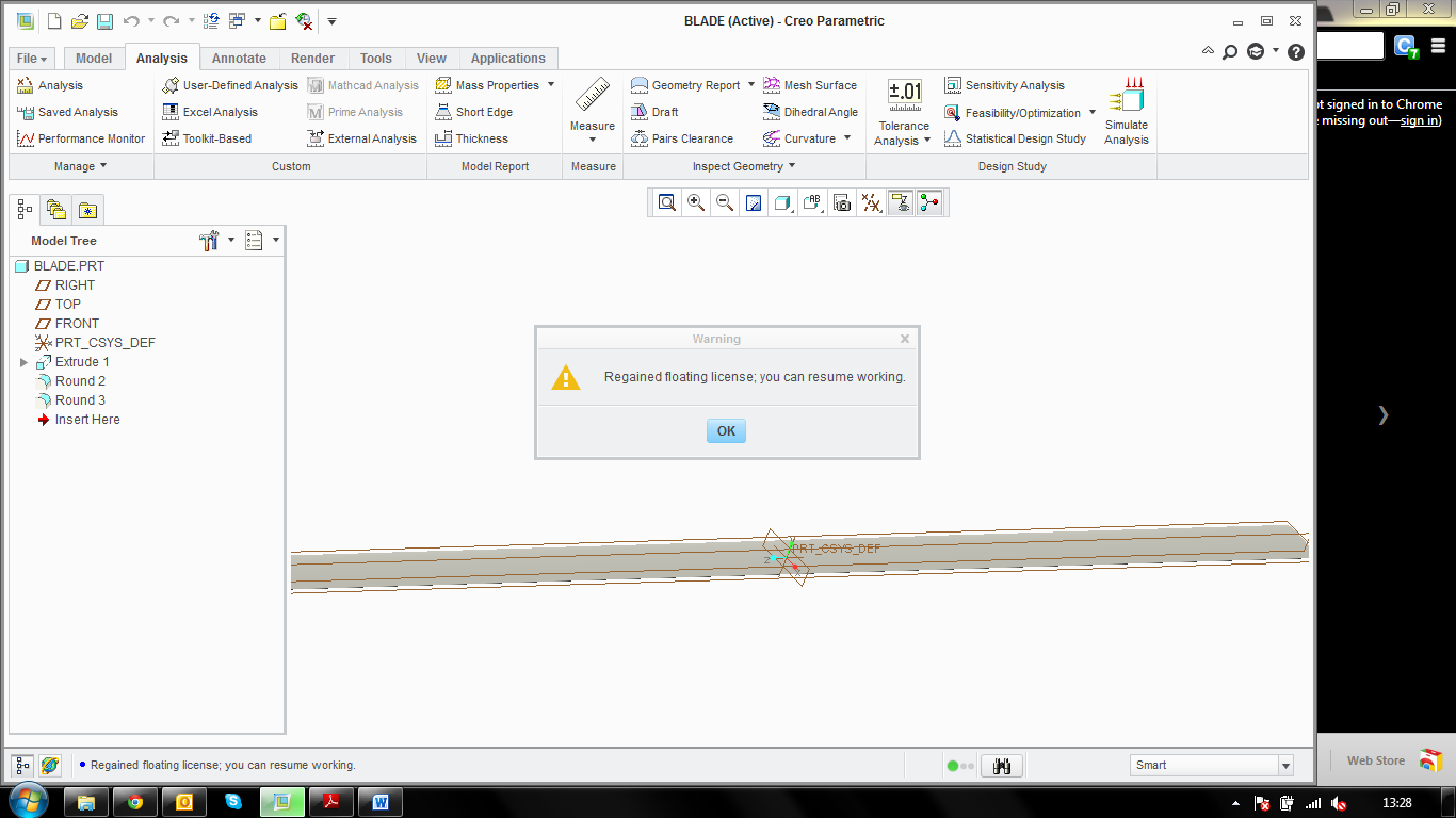

We are using a server based license-with 5 number of license of 7 but in some cases,Server is not getting back the closed user license to retrieve with other available users
and also repeatedly We are getting "floating license regained"and disturbs the lot,if u can sort out this issue it will be more Useful to Us

Sometimes ptcflush does not free locked license. The only reliable method is to stop/start FLEXnet system service (FLEXlm server for PTC OR lmadmin_ptc).

When the license isn't returned to the pool, you should use ptcflush.bat. Mine is located in "C:\Program Files\PTC\Creo 1.0\Parametric\bin". Your path will probably be different. If you use a command prompt and type "ptcflush", it will tell you the arguments that it wants. You get the feature through ptcstatus.bat, located in the same directory.
As to eliminating the floating license regained message, Iook at config option suppress_license_loss_dialog.

we r doing exactly the same thing for now, stopping the server and starting it again. the flush process has not worked even once for us.
Is there any other possible way to remove the locked licence from the working computer?
