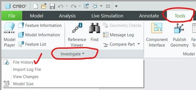

Excuse me, guys
How do I know how much time I spend drawing 3d model with creo parametric?
How to set a timer with Creo 3.0?
Thanks a lot!
Have a nice day!

@Haydena
I think there is no such option which will provide you total time lapse for part creation. If required, you can manually calculate the same using Date & Time functions. But as I said it will not provide you the lapse time, it will add time stamp on accessing the command which can manually collect and calculate at the end of task.

Thank you for responding.
I found the file history, maybe it could be solved my problem so far.

@Haydena
If file history resolves your query, it would be nice if you mark your reply as solution for the post.
