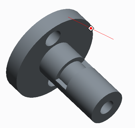

Dear all,
I have a problem with my flats in creo parametric 2.0
If I turn my model, the flats are always hidden.
Is it possible to change something in the settings so that the problem does not recur?
Thank you.

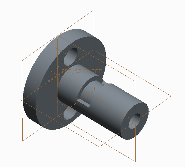

The first one is without turning my model. The second one is when i turn my model around. The flats are gone and i would like to see them everytime.

to see datum planes during model rotation, add the following option at the end of config.pro file
spin_with_part_entities YES
