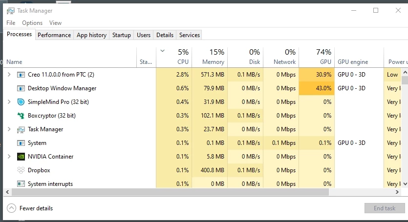

I have installed CREO Parametric version 11.0.0.0.0 on my Lenovo Thinkpad P53s on Windows 10 and I am experiencing a severe performance issue (I had the same problem with version 9.0.0.0 by the way)
Characteristics of my Laptop :
  • Operating System  : Windows 10 Pro version 22H2
  • Processor                 : Intel(R) Core(TM) i7-8665U CPU @ 1.90GHz 2.11 GHz
  • Installed RAM          : 48.0 GB (47.7 GB usable)
  • GPU 0                        : Intel UHD Graphics 620
  • GPU 1                         : NVIDIA Quadro P520 GPU1
Problem Description :
When moving a model on the screen or simply opening menus in CREO application, the graphic suddenly freezes for one or two seconds, making the work really annoying. After a while, all seems to be normal, until it restart to lag.
Analysis :
  • At first, I thougt iwas a problem with the NVIDIA GPU 1 settings. I specified all CREO processes as allowed to use the PGU 1. Also, I enabled Hardware Acceleration under Windows "Graphic Settings".  It did not solve the problem.
  • Then, I removed CREO from the list of applications using the NVIDIA GPU and disabled completely NVIDIA in the Windows Device Manager, with the objective to only use the native GPU 0 of my laptop. Unfortunately, it did not solve the problem
  • Then, I figured out that the "Desktop Window Manager" process is probably the cause of the problem. When making fast moves of the 3D model, I can see that the Desktop Window Manager process suddenly consumes a lot of GPU 0 , sometimes reaching 100% utilization !
  • With other graphic applications, I don't have the problem though
Of course, I made sure that that my Windows 10 is at the latest level. I searched on the internet for similar problem descriptions but unfortunately without success.
Can anybody help me ? It would be more than appreciated

Hi Martin,
Thank you for your reply and suggestion. I made the test as you mentioned but without change on my problem. However, your suggestion led me to the solution 👍
In fact, when looking at both GPUs utilization, I observed that Windows gets confused working with both GPUs at the same time.
Even if configuring the NVIDIA GPU1 for CREO, after a period of normal performance, the Intel GPU0 and the NVIDIA GPUs began to share the graphic load. At that moment, CREO lags a lot and the entire Windows becomes slow.
Today, I disabled the built-in GPU0 (Intel UHD Graphics 620) to only have the NVIDIA GPU active. This solved the problem !
Thanks again for support
Best regards,
Yves
Aug 12, 2024 7:45 AM UTC
execute "standard test". This means add following option at the end of config.pro temporarily.
graphics win32_gdi
If it resolves the problem then you have to try installing different version of graphic card drivers (if there are any of them).
INFO: NVIDIA Quadro P520 GPU1 is not supported.
https://support.ptc.com/WCMS/files/176375/en/Lenovo_11.html
