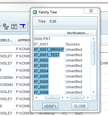

... and in case you don't know (like I didn't) that to verify the family table, you click on the little check box above a three columns (like shown on the top left below). It pops up a window (like shown below) and you click the verify box and it goes through and verifies each instance.
Thanks, Dale
