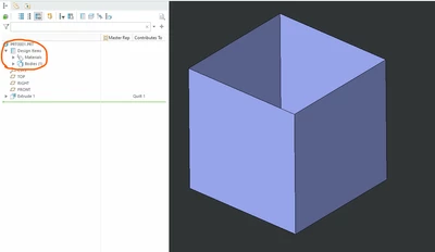

I am using Creo Parametric Release 9.0 and Datecode9.0.2.0
When I select a quilt in the model and hide it, the Model Tree does not update accordingly anymore*. As a consequence, it is not possible to show the quilt again by acting on the Model Tree.

see uploaded video.
Lawproto4-ParticipantAuthor
June 6, 2023

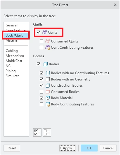

This seems very interesting, I tried to replicate the example and my problem seems to be I cannot see the section Quilts under Design Items.
How do I activate this feature?
