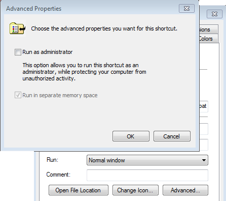

What I do is create a shortcut to the batch file.  Then the batch file needs to be marked as admin.
Right-click on the shortcut and select Properties.
On the shortcut tab select the Advanced button.
Then check the box of Run as administrator.

I cannot make the bat file run as admin because of security things we have in place.
