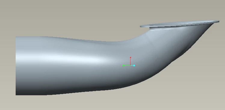

I have a weird part that will have a crazy split line and
would like to create a silhouette curve of where I think the split line will
be on the surface but at the moment I do not have access to mold license. I
know in ProMold I can create it but is there a way to create it in a regular
flex engineer license?
This is the view I want the curve to fall on the part. I tried to create a
sketch and then project it to the surface but some areas of the part I
cannot use the project on some of the edges of the part.
Thanks.

1 copy all exterior surfs.
2 Use a surface trim operation via plane- trimming the quilt created in 1.
3 normal of the trimming plane should be coincident with your pull vector
4. i believe there is a fly-out or option to trim via silhouette
5. perform the trim.
6. create a composite datum curve on the trimmed edge of the quilt.
7. layer off the quilt....to only see the curve..

February 11, 2015
Copy the geometry.
Paste the geometry.
Create a surface extrude where you want the parting line.
Create an intersect feature between the extruded surface and the copied geometry.

February 12, 2015
Thank you for all the suggestions and I got the curve I needed with using this method recommended by Pete. I did not get a chance to try Charlie’s method. I will try that one when I get this project done.

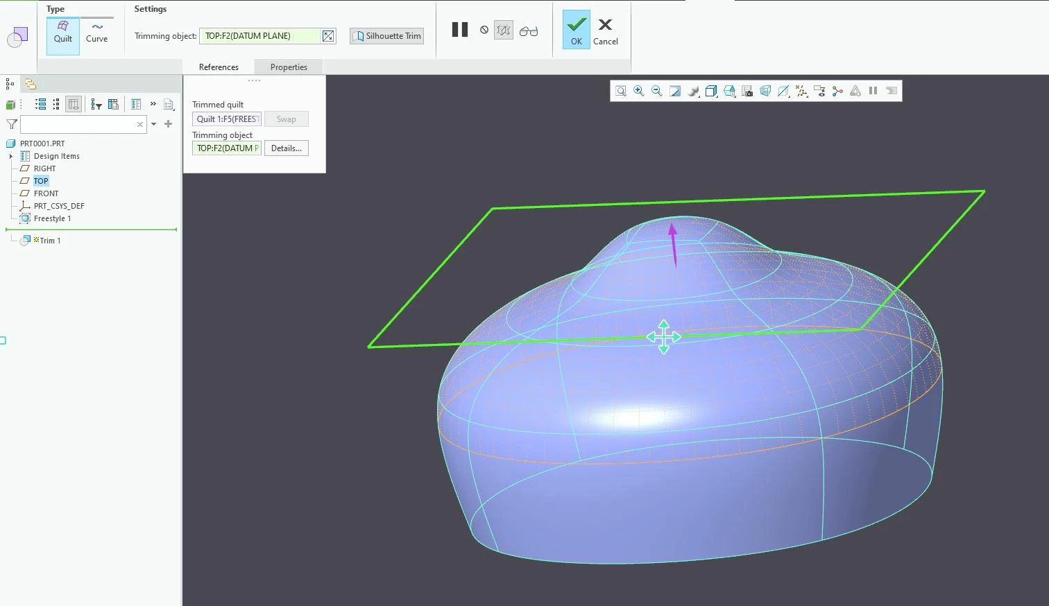

December 26, 2023
You can find the silhouette trim feature in the trim command.
Make sure to choose a directional surface (in this case a datum plane) to use as a reference.
Please see the attached image.
