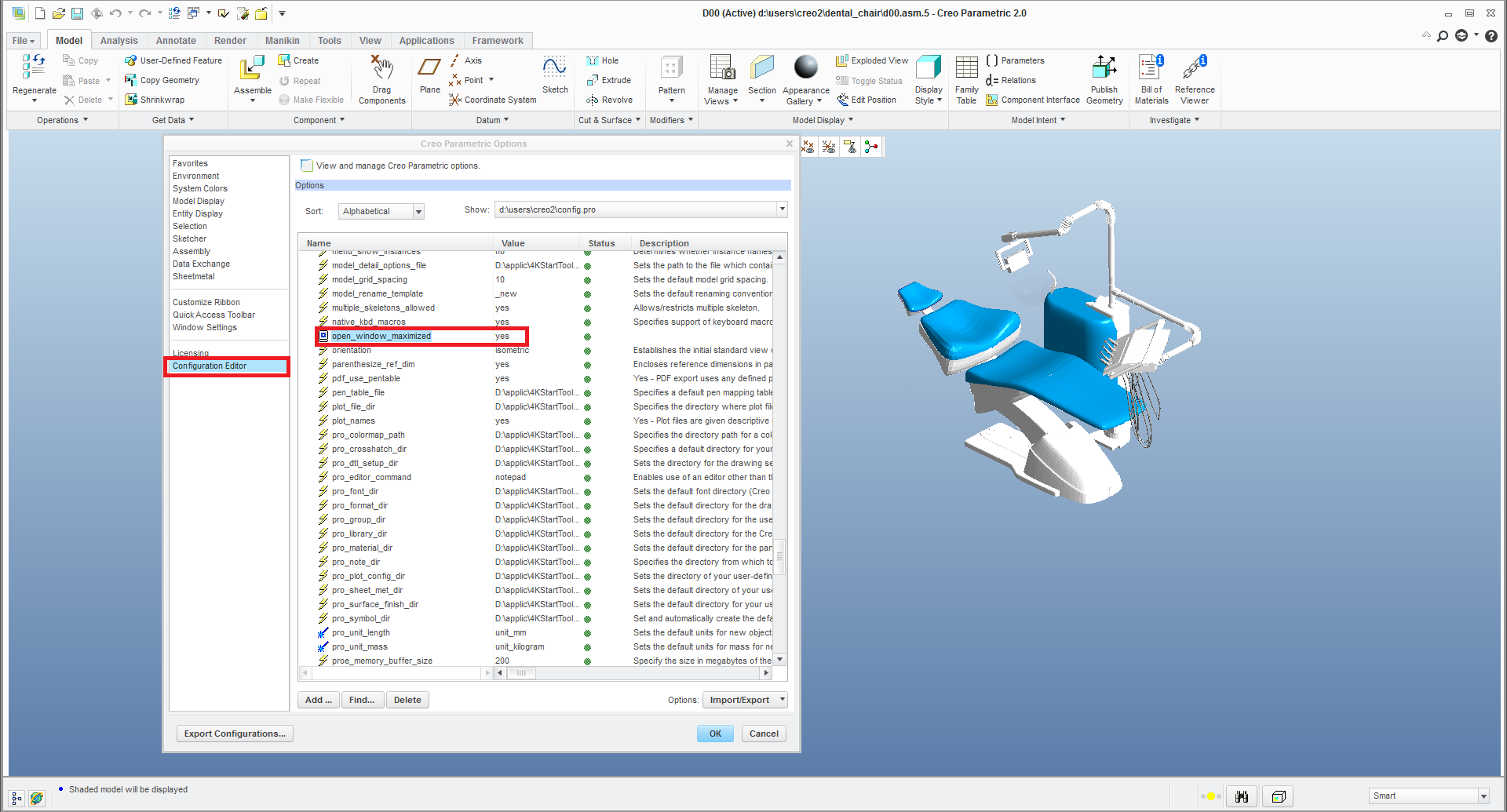

does anyone know a way to manipulate the size of the creo startup configuration window where the use chooses his configuration/license to start Creo 2.0 Parametric?
I would like that this window is larger so the user can see all options at once without the need to scroll within the window.

Hi Axel,
set configuration option:
open_window_maximized yes

Mar 28, 2013 7:43 PM UTC
Hi Denis
The configuration option: open_window_maximized - is hidden option
You can use it - here is my configuration file:
Set the option:
open_window_maximized yes >> save config.pro file and restart Creo.
Vladimir
