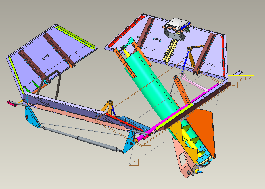

Im doing fair amount of mechanisms myself but my analysis times were never that high(15min max).
Using lot of cams and smaller time increments usually slow analysis down.
Can you give us example of what your mechanisms look like? But im guessing problem is completly unrelated to design.

Here is the assembly I am working with.  I have the assembly powered with a servo motor on the hydraulic cylinder in the lower left corner of the pic.  Basically this assembly closes inwards on top of itself.

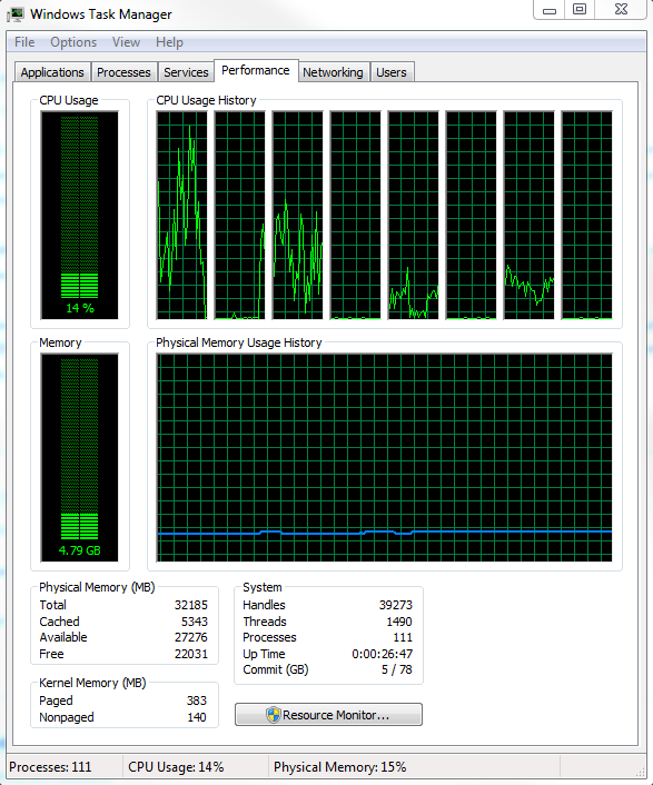

Here's a shot of the Task Manager during analysis.

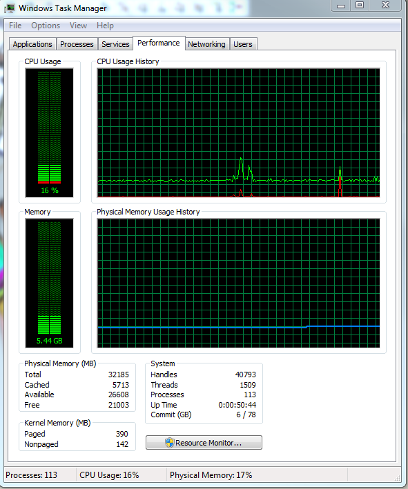

Eight cores showing, so it does seem very likely that it's one core running flat-out.  Personally I prefer the other view, One Graph All CPUs - there you should see a nice flat line showing the total processor load, rather than watching how Windows spreads the load among the cores (which I really couldn't care less about - although I notice that it's only loading four of the cores, not sharing the load onto the 'virtual' ones).
I also enable Show Kernel Times, which (as I understand it) will at least give some indication of when the CPU is occupied with disk access and other 'low-level' activity.
June 30, 2015
Kind of like this....
