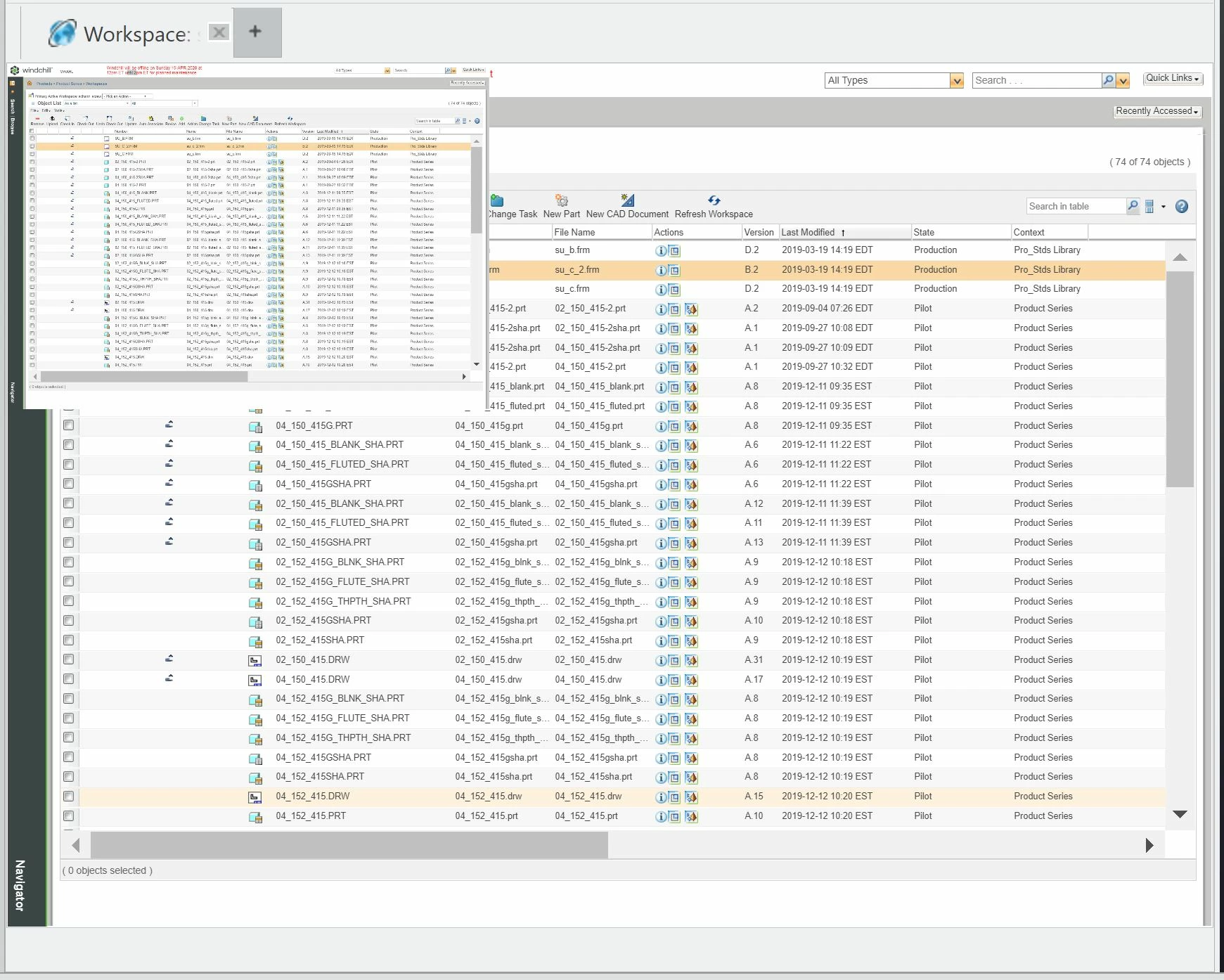

Smaller window popup within Creo Browser (workspace) window
I am getting a weird window popup when ever I try to maneuver within the workspace window and it is extremely hard to function.  How do I keep this from happening?
See the attached screen capture.
Creo parametric 5.0.4.0
Windows 10
Thinkpad P52 laptop

I think some display problems are related to display scale setting. Try setting it to 100%.

@mica359
I think it is somewhat slimier to issue reported in post at
https://community.ptc.com/t5/System-Administration/Embedded-Browser-Issues/m-p/153603
It will worth trying the solution in post.
