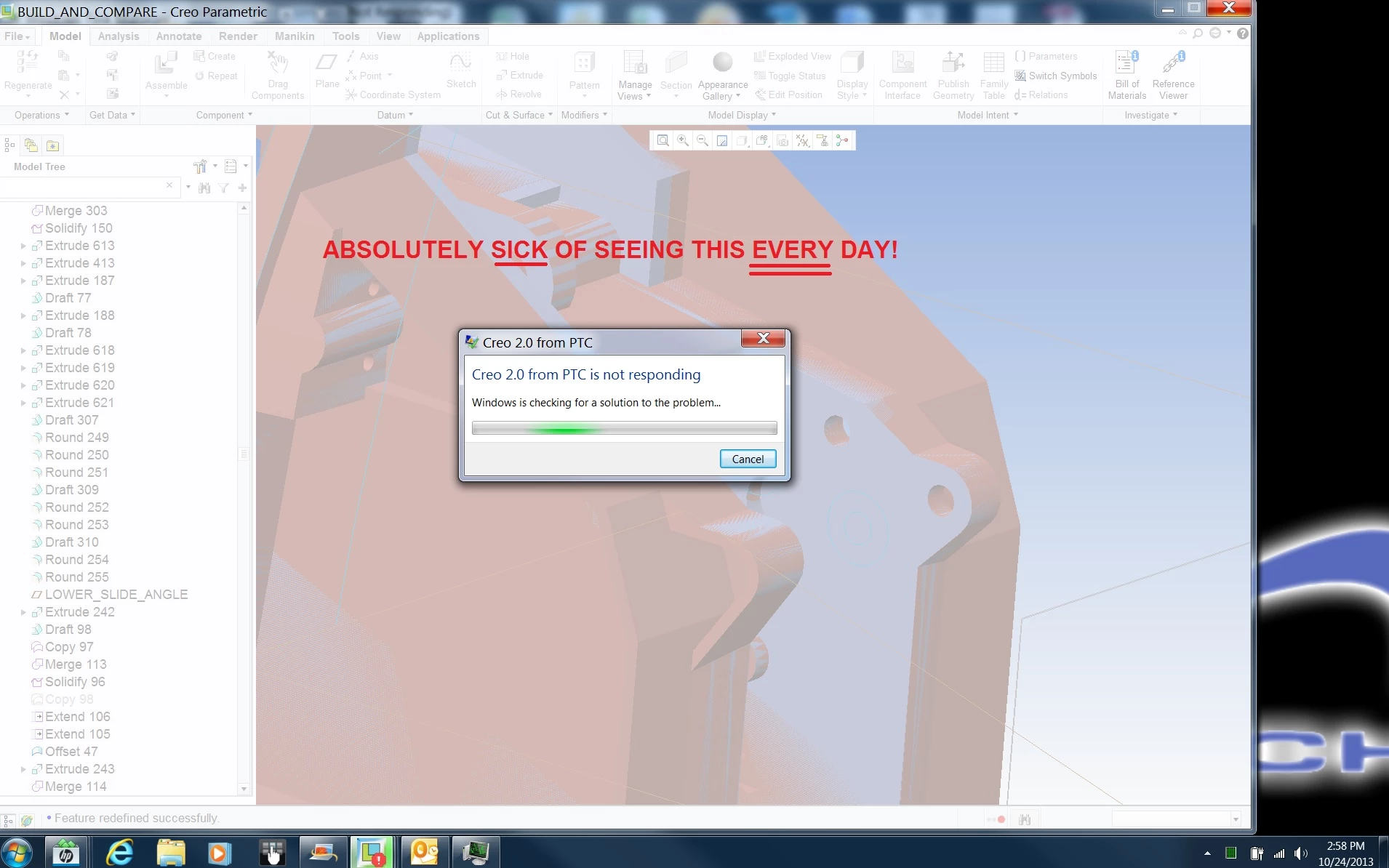

Sorry to post this here....but I had no choice.
It's a good thing I live in an area where there are no tall buildings.

    Oct 24, 2013 8:34 PM UTC
    Something is wrong with either your computer, or your Creo configuration. This is not normal.
    See the list in the attached pdf, it's from my Creo Admin 102 talk in June.
    Also go to File, Help, System Information.
    Scroll down to the section titled "Configuration Information"
    That will show you what config files have been loaded into session and where from.
    You'll want to check those files.
    Also look for a std.out file in the startup dir. That will list any obsolete config options.
    You really want to go through all your old mapkeys, and recreate them for Creo.
    Old config files can cause problems in Creo.
    Also if you use the config editor inside of Creo, it's really easy to duplicate your entire config when you save. Thousands of lines in the config from such a duplication can cause problems.
    If you are on any release of Creo before m060, you should update the software. The current release is m080, just released last week.
    The oldest release you should be on is m060.

    DeanLong1-VisitorAuthor
    Oct 25, 2013 9:41 AM UTC
    Now boys, let's play nice. 🐵 My post was not start a flame, merely to express my frustration. Tight time schedule with a looming deadline has the atmosphere a little tense.
    Neil and Patrick, you both expressed my thoughts perfectly. However, being a PTC Kool-Aid drinker going on 25 years now, it's very, very old news that the software has been shaky and unpredictable it's entire life. It has always been a product revised and released too much, too fast within each rev. That is simply the pond we find ourselves swimming in.
    David, you bring up some great points. If it were as simple as taking time out of the week to chase down all the "possible" reasons why 2 hangs, I may not ever get my job done. Navigating the PTC site is cumbersome enough. Downloading, uninstalling, re-installing, debugging, loading new configs (if it was the old ones causing the issues) is not always a simple task. It was mentioned that by the others that the software should work, period. Yes, sadly I know the MCAD business unit of PTC is now only a small portion of the iceberg that is visible. PTC is, IMO, spread toooooooo thin and is trying to be all things to all companies. Itwasn't always that way. But now the need to do all things "Data Life Cycle"has left us with a Data Management software instead of a Design software. Sorry.....I got started....I will quit that folly.
    To the point, some answers Iknow straight away.
    I do not use mapkeys...never have. I have always used Pro straight out of box. I have alwas had the thougth they were counter-productive for me in the way I use Pro. I have done a ton of training and mentoring in the past and it made sense to stay true to the original flavor when training. It's a habit/style that has remained.
    I created new configs when I loaded and launched2 for the first time. If fact, I was sick of seeing the editor every day because I was nauseous with the color scheme of Creo. Whomever was responsible for the complete overhaul of the colors should be taken out behind the wood shed. I wish it were as simple as "gooing back" to the Pre-Creo but EVERYTHING has changed. At times, I wonder why I didn't just buy SolidWorks because it seems the programmers tried very much to copy the look of the other software company in town. Many forget the reason SW looks the way it does is because they wanted to look "different" that Pro. Now we just look silly that we have copied them. And....who thinks dull gray parts on a bright white background it good for ones eyes anyway? The world has gone mad.
    I have been trying to noticea patternwhen my system hangs. It seemed to be when spinning/panning/zooming the model. However, yesterday's final straw was I moved the cursor within the screenafter the model sat idle while I was on the phone. It locked and required a restart of the whole machine.
    Eventually, I will have a break in my schedule to allow for the update. Until then...Save (more) Often (than usual).

    Let me weigh back into this conversation.
    My intention was not to assign blame but to provide solutions.
    But since, I guess, it came across as blame, I'll own that, and say it comes out of real world experience.
    Ultimately the blame goes to the software and PTC, as many of you have said.
    But in the end, assigning blame, doesn't fix the problem. It might make you feel good, but your still left with the problem.
    We went live with Creo 2.0 in March with rev m030. This was after I'd been working on the configuration and installation issues for about 10 months.
    Let me also say that it wasn’t just our group, we when live on m030 across most of the DOE/NNSA Laboratories. So it was a large number of users.
    For most folks it went relatively smoothly, but we had a number of users that had graphics problems.
    We had to update graphics drivers on those machines, there were two machines where we just decided to update the graphics cards because they were so old.
    This is not unique to Creo. I remember having to update the graphics drivers often when Wildfire came out. Finally after 6 months the vendor had a driver that was stable.
    The thing is, m030 was slow and we had a lot of problems with the interface to PDMLink. I updated everyone to m040 as quickly as possible.
    That was an improvement, but there were still issues and it was still slow. M050 provided some performance increase, m060 was a significant improvement.
    Both m050 and m060 were far more stable than anything preceding them. Currently I'm running m070, and plan to get m080 ready to roll out next week.
    That takes care of graphics drivers and maintenance builds. Let's now look at my experience with config files and users
    I'm sure you have users that have created their own config files, because they want a different work environment.
    Perhaps they work on large assemblies and want different default behavior because of that. That's the beauty of the software, each user can customize their environment.
    What I found after going live with m030 was that the users that were crashing a lot, had copied their old personal config from Wildfire 4 to use in Creo.
    The thing you need to realize is there are config options that get obsoleted with every revision of the software. And with Creo, some options changed spellings and meanings.
    For each of these users we went through their personal config, removed all the old mapkeys, and removed anything that was a duplicate of our default loadpoint configs.
    We would then start up the software and look for a std.out file that would warn of any problem config options. Then we fixed those.
    One user had a config file in their %HOME% directory that we didn't realize was getting loaded. Looking at System information showed us that file.
    Turns out it was about 4 years old. We just eliminated the file and his problems went away.
    The other issue is the config editor. In the early versions of Creo it was seriously broken. If you saved, it copied the entire session config into your personal config file.
    Even in current revs, if you don't know how it works now, you will do the same thing. It doesn't work like it used to, shame on PTC, because it was great in WF4.
    I had users that had added one option to their personal config, and ended up with a complete duplication of the config.sup, load point config.pro and any other configs that had been loaded in session.
    And sometimes not just one copy of those, multiple copies. Ever seen a config with over 10k lines? It causes problems.
    Finally about the issue that upgrading a lot of users is a pain in the neck, or even lower down. There are ways around that.
    My talk at the conference in June was on how to do that. If you want a copy of that talk, send me an email and I'll send you the PDF.
    People at the conference liked the talk well enough that I received the best overall presenter award for it.
