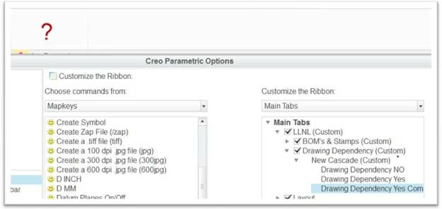

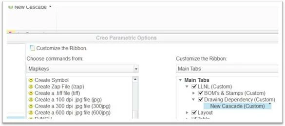

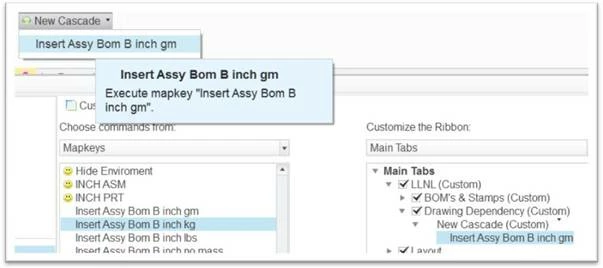

So I heard back from PTC about this problem today.
"I have filed a HIGH severity SPR for your issue."
You may want to try this on your systems to see if you have the same issue.
My mapkey loads a config file. It works if you type a key name, but doesn't show in the ribbon when you add it to a new Tab.
If you have been able to get a mapkey that loads a config file to work, and more importantly to show up in the ribbon, I like to hear from you, so I can figure out how to make this work.
This is my mapkey, you will need to change the hi-lited sections.
mapkey /ddn @MAPKEY_LABELDrawing Dependency NO;\
~ Select `main_dlg_cur` `appl_casc`;\
~ Close `main_dlg_cur` `appl_casc`;\
~ Activate `main_dlg_cur` `appl_menu.left_pane.options_button`;\
~ Select `ribbon_options_dialog` `PageSwitcherPageList` 1 `ConfigLayout`;\
~ Select `ribbon_options_dialog` `ConfigLayout.ImportExportBtn`;\
~ Close `ribbon_options_dialog` `ConfigLayout.ImportExportBtn`;\
~ Activate `ribbon_options_dialog` `ConfigLayout.Open`;\
~ Trail `UI Desktop` `UI Desktop` `DLG_PREVIEW_POST` `file_open`;\
~ LButtonArm `file_open` `tb_EMBED_BROWSER_TB_SAB_LAYOUT` 3 520 18 0;\
~ LButtonDisarm `file_open` `tb_EMBED_BROWSER_TB_SAB_LAYOUT` 3 520 18 0;\
~ LButtonActivate `file_open` `tb_EMBED_BROWSER_TB_SAB_LAYOUT` 3 520 18 0;\
~ Input `file_open` `opt_EMBED_BROWSER_TB_SAB_LAYOUT` \
`P:\\mapkey_configs\\dependency_no.pro`;\
~ Update `file_open` `opt_EMBED_BROWSER_TB_SAB_LAYOUT` \
~ Activate `file_open` `opt_EMBED_BROWSER_TB_SAB_LAYOUT`;\
~ FocusIn `file_open` `EMBED_BROWSER_SEARCH_IP`;\
~ FocusOut `file_open` `EMBED_BROWSER_SEARCH_IP`;\
~ Activate `file_open` `Open`;~ Activate `ribbon_options_dialog` `OkPshBtn`;\
~ FocusIn `UITools Msg Dialog Future` `no`;\
~ Activate `UITools Msg Dialog Future` `no`;
