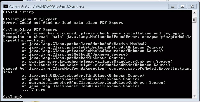

i feel like i am missing a step somewhere and i need help working out what i am doing wrong.
1st. i am an experienced coder, however, most of my time is spent in C# so i am confident i know how to code what i need to.
i just need to know how to compile and run an async application????? (J-Link)
here is what i have done so far..
  1. I am using the following command to compile my java application
    C:\DEV-LIBS\JavaJDK_8_144\bin\javac -cp "C:\DEV-LIBS\Creo\Common Files\text\java\pfcasync.jar" Sample.java
    this seems to work correctly and the Java File is compiled correctly
  2. Now when i run the tool
    C:\Temp>java Sample
    i get an error saying.
    Error: A JNI error has occurred, please check your installation and try again
any help would be appreciated

July 27, 2017
Thanks for the quick reply.
let me clarify.
i am just trying to run the class, it is a very simple application (at the moment all i want it to do is open a drawing in Creo)
once i can run a simple app i will have no issue writing the code, i just can't get .class to run. (i have also tried .jar, with the same result)
i am on a windows PC with creo3.0.
i am attempting to compile and run the application through cmd.exe
as i mentioned, i can compile ok however (it seems) however i am not able to run the application.
see attachment for error.
Anyone have any idea what the issue is?
July 30, 2017
I think you missing some of your loosely linked Librarys.
So I use a starter to startup with the right environment variables you need to run async connected tools.You can start and use the starter with ....exe -d to start it in development mode and push in your startcommands.
After that I compile with the pfcasync.jar and just start it.
Br,
