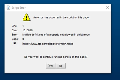

Starting Creo - Error
This morning while booting up Creo 4.0 M060 I had this error pop-up
Any thoughts as to what might be causing this?
Thanks, Dale

probably PTC changed their web page ... and integrated web browser "does not like its contents".
Suggestion ... add following option into config.pro file
web_browser_homepage about:blank

Martin,
That suggestion did not work.
Dale
(Yes, I did restart Creo after adding that line to the config.pro)

We get this due to some IT settings. It seems to be related to the same issues as browser compatibility mode. Try running the fixes from this article https://www.ptc.com/en/support/article?n=CS23522&language=en&posno=1&q=browser%20emulation&source=search

Our users are currently also having this issue at every start-up of Creo4.
The web content of the "Resource Center" is causing this script errors.
I reported the issue to the tech. support today.

please check whether following config.pro option resolves the problem.
enable_resource_browser_tab no

After reboot, still getting the script error.

Good morning.  We are seeing this internally at PTC also.  It is not release specific.  A SPR has been filed for it, and is currently under investigation with the R&D team.
CS318514 - Error during startup in "Resource Center": "An error has occurred in the script on this page" in Creo Parametric
