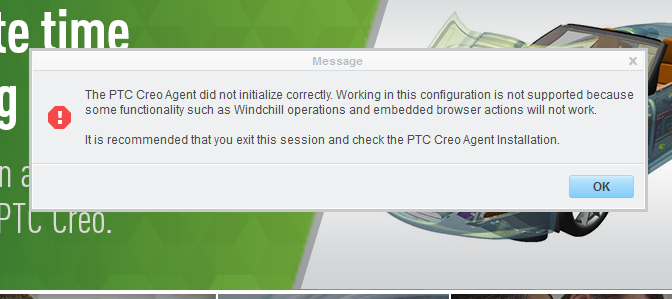

Every morning for the last couple of weeks, when starting Creo, I get this error message:
When I click "OK", Creo starts and I continue on as I normally would. But it takes about 10 minutes to get from the log in to this message, so I sit and wait for the message.
Our IT guys don't have an answer and PTC support hasn't been very timely getting back to me on this.
Any ideas out there in Community Land?

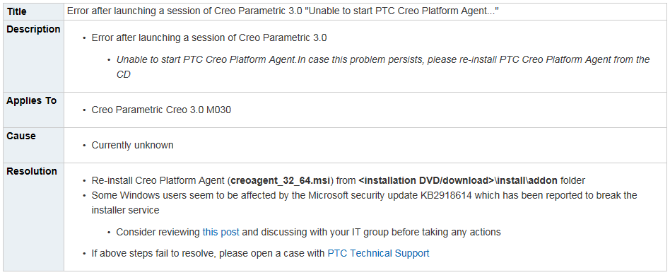

The message indicates there is an issue with the "Creo Agent", not the Quality Agent.
