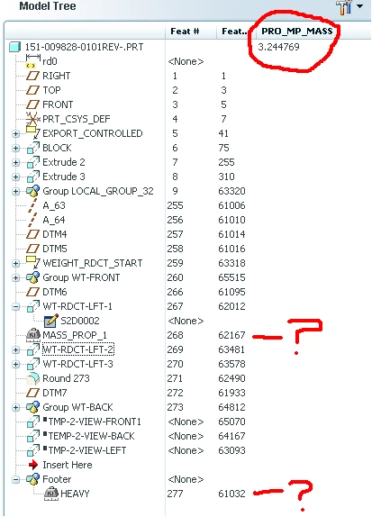

I needed to add a column to the model tree.
In the model tree columns box pull down: Type > Mass Properties Parameters > PRO_MP_MASS
For PRO_MP_MASS to stay up-to-date you need this config setting that recalcs mass on every regen:
mass_property_calculate automatic
It seems that for the mass information I did not need to create an analysis feature, and don't have to worry about a footer.
Thanks to Mike!
I can't get the analysis feature to display the mass in the model tree yet. I might need this functionality for measurements other than mass in the future.
~Doug

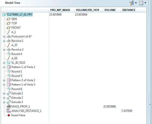

One more thing. You aren't going to see the results from your analysis in the model tree under the PRO_MP_MASS column because that is not the name of the parameter in that feature. If you want to see the value of a feature level parameter, you need to add that specific parameter as its own column. You can easily do this by setting the tree columns type dropdown to "Feat Params" and then typing the name of the parameter you want to see in at the bottom where it says "Name". After entering the value, just click the >> arrow so it gets added to the list of active columns. If you are unsure of the parameter name, right click on the feature and choose "info". At the bottom of the page it will list the available parameters for that specific feature.
Something to keep in mind is that different features can each contain a parameter with the same name. The parameter is unique to that feature. This is very handy when you want to see a unique value from multiple features but you don't want a separate column for each one.
Tom U.
