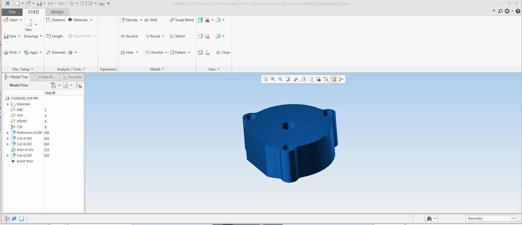

This driving me up the wall! - Creo 4 F000
  I had deleted all version of .ui and working only with a ...._admin_ in effectively /text ( file symbolically linked)
   Almost every time I go from part mode to assembly mode the order of the groups swap around. I reset them and then next time I go back they have swapped again. Then the order in cascades changes for no apparent reason .
    Is anyone else seeing this type of problem? I am trying to get something for a course in 3 weeks and I am spending all my time chasing mods which seem to be self generating. I have no faith at present that what goes in front of the students will be the same as the screen grab in the notes.
Just went back to get a screen grab of the window to show and things have changed again, see below
One of the icons has gone large, the spacing of the icons is all over the place, the commands in the Operations group are missing
and I can't even change the window width!
Trying to recover the situation leads is impossible as the New icon is already shown as small!
Rebooting doesn't solve the problem.
re-deleting the creo_parametric_customization.ui file in my rerooted %APPDATA% directory brings some more stability, and the group areas are refilled, but groups are still moving around when moving between modes. [Is there any way of stopping the system writing to APPDATA? My main .ui file is about 300K, but the one in %APPDATA% seems to vary between 15->50K. I assume it is only the  update information, but why does it seem to interact with the main _admin_ version even within one session?]
