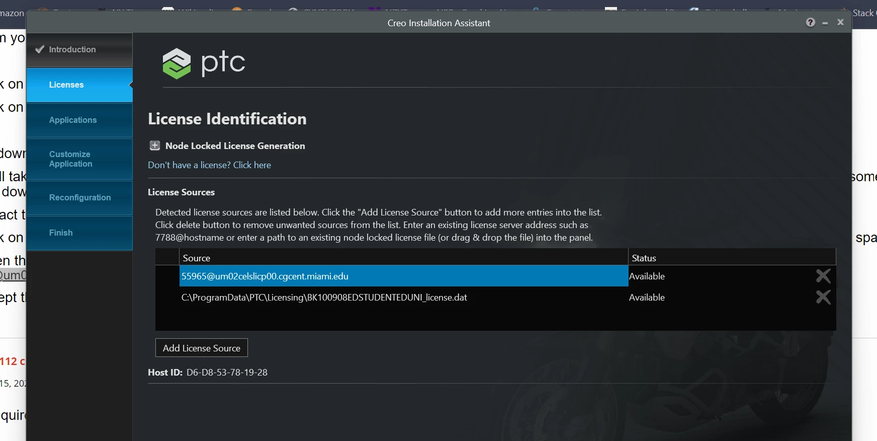

I was using Creo (v10) under a school given license for about 4 months. Since this license only worked at campus and I needed more time to work, I decided to add the online student license that my friends recommended to me.

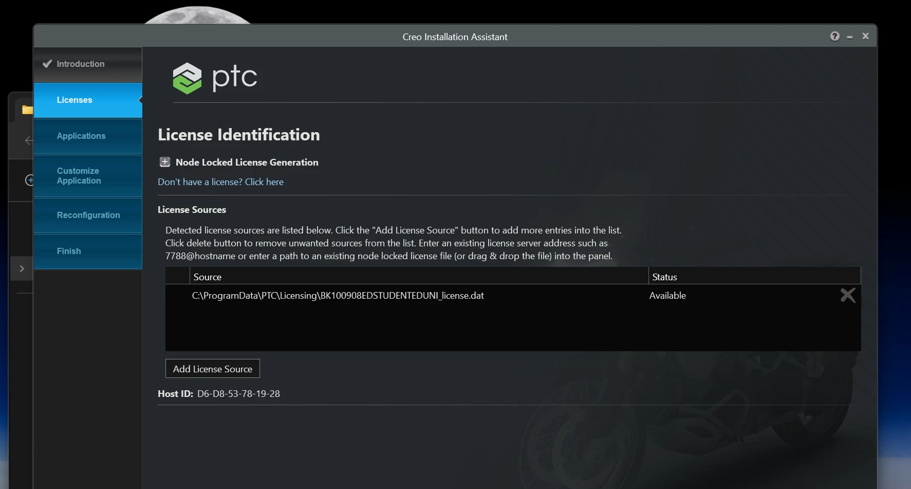

At first, it was not working and continued to operate under the school's license and did not work away from campus. Then I went on my desktop to Creo open file location> Reconfigure. Here I went to the licensing page where I only found the student license. I accepted and went through with everything hoping that Creo would now work under the student license like how I wanted it to.

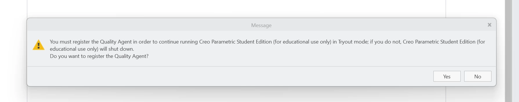

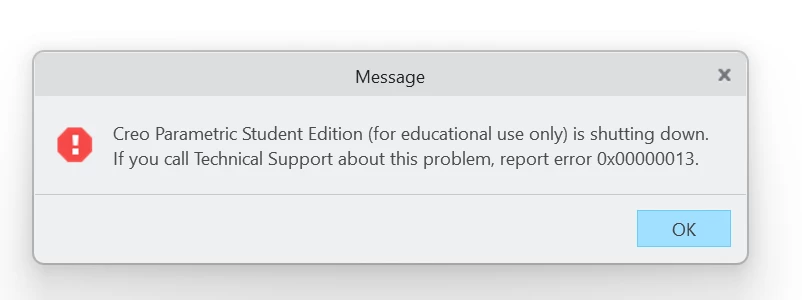

Instead, now every time I open Creo it says that I must register the Quality Agent for Creo to keep running and when I allow it to register it it says that Creo is shutting down under code 0x00000013.

in my installation the path to Quality agent exe file is E:\PTC\Creo10_030\DiagnosticTools\x86e_win64\obj\qualityagent.exe
Try adding following option at the end of config.pro file.
quality_agent_path <CREO_installation_directory>\DiagnosticTools\x86e_win64\obj\qualityagent.exe
To be able to use school's license and student license according your needs, you have to create 2 psf files in <CREO_installation_directory>Parametric\bin directory.
By default installation creates parametric.psf file, only.
My suggestion:
1.] rename parametric.psf file to parametric_school.psf
2.] copy parametric_school.psf to parametric_student.psf
3.] edit parametric_school.psf in Notepad
DESC=Creo at school
ENV=PTC_D_LICENSE_FILE-=55965@um02celslicp00.cgcent.miami.edu
ENV=CREOPMA_FEATURE_NAME=Here_enter_school_license_name ()
4.] edit parametric_student.psf in Notepad
DESC=Creo for Student
ENV=PTC_D_LICENSE_FILE-=C:\ProgramData\PTC\Licensing\BK100908EDSTUDENTEDUNI_license.dat
ENV=CREOPMA_FEATURE_NAME=Here_enter_student_license_name ()
5.] on Desktop create shortcut for <CREO_installation_directory>Parametric\bin\parametric.exe
set Start in directory properly
double click the shortcut to start Creo
