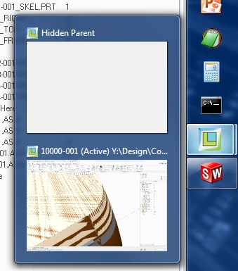

Summary: Creo 2 Window Issues
I wanted to wait for a bit to be sure this was the solution.
I have an Evoluent Vertical Mouse (which I love) and I uninstalled the Evoluent driver and it seems to fixed the problem.  The only thing I've lost is customizing the mouse buttons, which I'm OK with.
I know several of you also have a Vertical Mouse, have any of you experienced issues with the Evoluent Driver?
