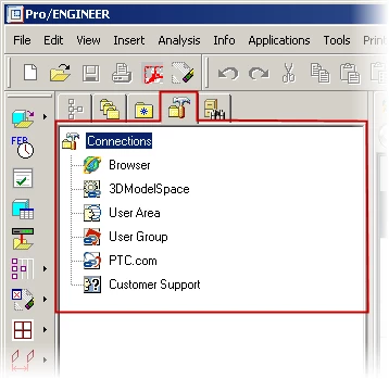

Other suggestions included adding the license server to the hosts file
and making sure that Pro/E wasn't attempting to access any blocked web
pages in the embedded browser.
