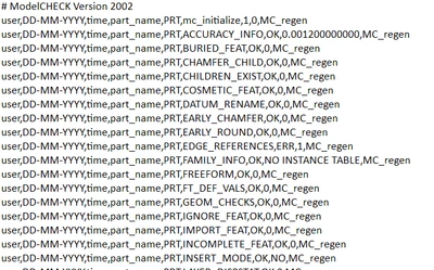

Thanks for your reply. The metrics does seem like it might have the functionality I'm looking for. I'm doing some testing, and right now it is outputting for each model run:
Username, Date, Time, Filename, File extension, mc_initialize, 1, 0, MC_regen
What I really want to get is if the model had errors or not. It seems to be reporting "1, 0" for every model. Any idea what this corresponds to, and is there a way to configure the metrics to maybe get a count of errors?

"Username, Date, Time, Filename, File extension, mc_initialize, 1, 0, MC_regen" in text file will remain same in each file. Information about Modelcheck will result in lines after the mentioned one, something like....

For anyone else interested in the ModelCheck Metrics function:
You have to enable metrics, as described here: http://support.ptc.com/help//creo/creo_pma/r7.0/usascii/index.html#page/model_analysis/modelcheck/To_Set_Up_the_Metrics_Program.html#
Once enabled, you must modify your check file (extension .mch) and set Metrics to Y for the settings you want reported to the file. It seems that not all settings support reporting, however.
The metrics file is essentially a log file of ModelCheck running. There is a line when ModelCheck starts processing a model, then it records out for each (supported) check (where Metrics is set to Y)  the result of the check.
But to my original intent, it seems there is no direct way to get a report into a spreadsheet of which models had errors. We may look into developing a script to parse the report files.
